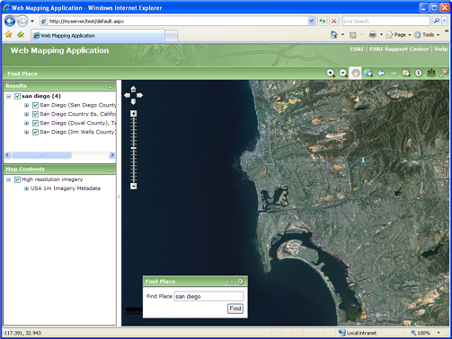

The Web Mapping Application below was created in Manager and uses an ArcGIS Online service.
