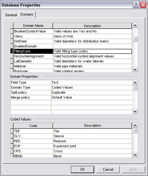

The domains for a geodatabase are accessed in ArcCatalog by way of the database Properties dialog box. Right-click the geodatabase, and click Properties.
Domains in the Database Properties dialog box
In the example above, all the domains defined for a geodatabase are listed at the top of the dialog box. The FittingType domain is selected in the list. The Domain Properties and Coded Values shown pertain to this selected domain. As shown in the Domain Properties, the FittingType domain is a coded domain.

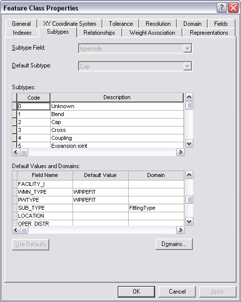

When a domain is applied to a subtype, it will be listed in the Subtype tab of the feature class properties dialog box. Right-click the feature class and click Properties.
A domain applied to a subtype of a feature class
The FittingType domain is being applied to the SUB_TYPE field of the Fittings feature class.
When you edit the attributes of the Fittings feature class in ArcMap, you will only be able to enter one of the codes specified for the FittingType domain in the SUB_TYPE field.

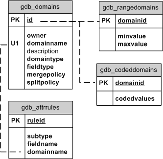

In the database, domains are stored in the system tables gdb_domains. Coded domains are tracked in the gdb_codeddomains system table, and range domains are tracked in the gdb_rangedomains system table.
The gdb_fieldinfo system table stores one record for every field in every user-defined table in the geodatabase. This table also stores the name of the domain (if any) that is associated with each field.
The gdb_attrules table stores the name of a field, the name of the domain associated with that field, the subtype code for the feature class, and the rule ID.
The following are the domain system tables. Dashed lines indicate an implicit relationship between tables.
