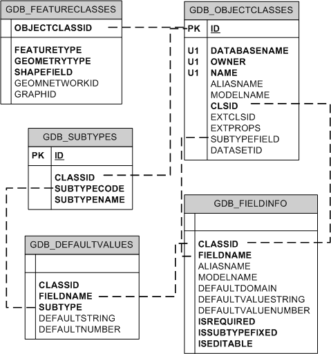

Subtypes in a DB2 DBMS
For the subtypes applied to the TYPECODE field of the Laterals feature class, the tables in a DB2 DBMS would look like those found in the diagram below.
Subtype tables in DB2
In this example, the Laterals feature class is composed of the LATERALS business table and is identified in the GDB_OBJECTCLASSES system table. Additional information about the feature class is maintained in the GDB_FEATURECLASSES and GDB_FIELDINFO system tables.
The subtypes for feature classes are tracked in the GDB_SUBTYPE system table, the default values for the subtypes are tracked in the GDB_DEFAULTVALUES system table, and the fields to which these apply are tracked in the GDB_FIELDINFO system table. The subtypes are associated to the feature class by way of the GDB_OBJECTCLASSES table. The GDB_DEFAULTVALUES table is associated with the GDB_SUBTYPES table by the subtype code, which is stored in the SubtypeCode field in the GDB_SUBTYPES table and the Subtype field in the GDB_DEFAULTVALUES table.
The name of the field to which the subtype applies is stored in the SubtypeField column of the GDB_OBJECTCLASSES table. This field is linked to the FieldName column in the GDB_FIELDINFO table, which in turn is associated to the FieldName column in the GDB_DEFAULTVALUES table.
