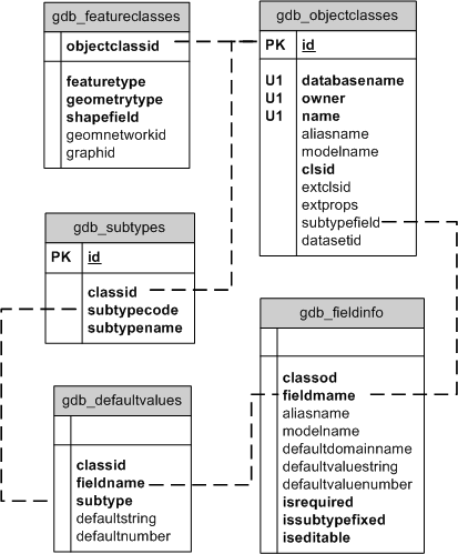

Subtypes in an Informix DBMS
For the subtypes applied to the TYPECODE field of the Laterals feature class, the tables in an Informix DBMS would look like the following:
Subtype system tables in Informix
In this example, the Laterals feature class is composed of the LATERALS business table and is identified in the GDB_OBJECTCLASSES system table. Additional information about the feature class is maintained in the GDB_FEATURECLASSES and GDB_FIELDINFO system tables.
The subtypes for feature classes are tracked in the GDB_SUBTYPE system table, the default values for the subtypes are tracked in the GDB_DEFAULTVALUES system table, and the fields to which these apply are tracked in the GDB_FIELDINFO system table. The subtypes are associated to the feature class by way of the GDB_OBJECTCLASSES table. The GDB_DEFAULTVALUES table is associated with the GDB_SUBTYPES table by the subtype code, which is stored in the SubtypeCode field in the GDB_SUBTYPES table and the Subtype field in the GDB_DEFAULTVALUES table.
The name of the field to which the subtype applies is stored in the SubtypeField column of the GDB_OBJECTCLASSES table. This field is linked to the FieldName column in the GDB_FIELDINFO table, which in turn is associated to the FieldName column in the GDB_DEFAULTVALUES table.
