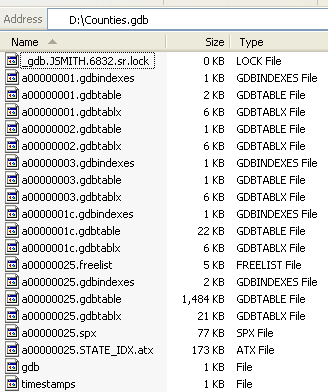

A file geodatabase stores as a folder of files. When you view the folder with Windows Explorer, apart from the .gdb extension, it looks like any other folder and you can view its contents. The folder contains cryptically named files that hold geographic data, attribute data, index files, lock files, and a signature file as well as other files. Each feature class or table in the geodatabase is stored in two or more files. By design, it is difficult, if not impossible, to tell which files make up any given dataset.

In file geodatabases, it is not possible to use Windows Explorer to perform an operation on an individual dataset. Renaming and deleting individual files in a file geodatabase folder and copying files to another location cause data loss and can render the geodatabase unusable. For example, if you use Windows Explorer to move files to another geodatabase folder, you won't be able to access the data. The contents of a file geodatabase folder are given cryptic names by design to discourage such operations. Operations on individual datasets can only be performed through ArcGIS.

ArcGIS ensures data integrity by preventing multiple processes from simultaneously accessing data in conflicting ways. ArcGIS keeps track of processes by placing *.lock files in the file geodatabase folder each time a process accesses a dataset. When the process terminates, its lock files are automatically deleted.
When a process ends prematurely or crashes, lock files may be temporarily left behind in the geodatabase folder. ArcGIS eventually removes these files in future sessions as new locks are taken. In the meantime, such files do not continue to lock data, and as they take up no disk space, removing them provides no benefit. If you still want to remove them, you can delete them with Windows Explorer. However, exercise caution when doing so—accidental deletion of files other than lock files will likely corrupt the data. If when you delete the lock files you notice that some cannot be deleted, it is because they are still active—another process on your computer or another one is still accessing the data. You will not be able to remove these locks until the processes holding them terminate.
