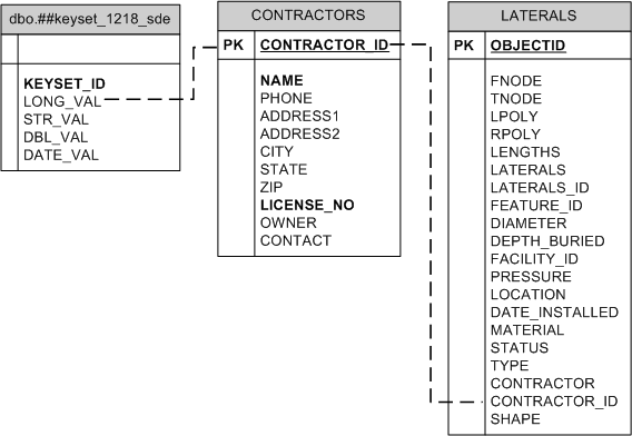

The following is a keyset table for a selection made between the related tables LATERALS and CONTRACTORS. In this case, the LONG_VAL field would be populated and contain the values of the CONTRACTOR_ID field on which the relationship class between LATERALS and CONTRACTORS is based.
Keyset table and its associated business tables in SQL Server
