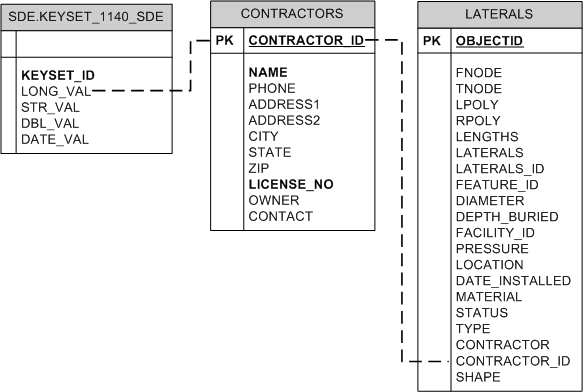

The following is a keyset table for a selection made between the related tables LATERALS and CONTRACTORS. In this case, the LONG_VAL field would be populated and contain the values of the CONTRACTOR_ID field on which the relationship class between LATERALS and CONTRACTORS is based. Notice that the user schema is SDE, which would indicate the user who caused the keyset table to be created did not have CREATE TABLE permission in the SDE database.
