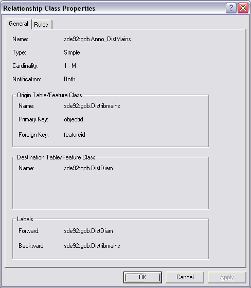

You can view information about relationship classes by right-clicking the relationship class and clicking Properties to open the Relationship Class Properites dialog box.
Relationship Class Properties dialog box

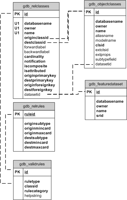

Relationship classes with a cardinality of one-to-one and one-to-many do not require a new table to be created in the geodatabase to store the relationships. All the system metadata required to manage the relationship is stored in the gdb_relclasses system table. The rules that are defined for the relationships are stored in gdb_relrules.
Relationship class system tables in Informix
Relationship classes with a many-to-many cardinality, however, do require a new table in the database to store the primary keys from the origin and related destination datasets that maintain the relationship between the two datasets. The name of the table that stores this information is the name of the relationship class.
This table may also have other fields to store attributes of the relationship that are not specific to either the origin or destination class but are a property of the relationship itself. This is known as an attributed relationship. For example, it may be useful to add some metadata or descriptive text for each related pair in the relationship class for future reference. See the topic Relationship class properties for illustrations and further information on relationship classes with many-to-many cardinality.
