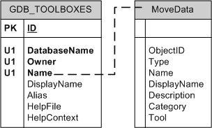

Only two tables are needed to represent toolboxes in a DBMS: a business table to store information about the tools in the toolbox and a system table—GDB_TOOLBOXES—to keep track of the toolboxes. The following are the tables for the MoveData toolbox:
Toolbox tables in SQL Server
These two tables are associated by the Name—the value in the Name field of the GDB_TOOLBOXES table corresponds to the business table name. This is an implicit relationship, as denoted by the dashed line.
As indicated by the names in parentheses following the table names, the GDB_TOOLBOXES resides in the ArcSDE administrator's schema (sde) and the business table resides in the user's schema (RJP). The GDB_TOOLBOXES table is created when you create the geodatabase; the business table doesn't get created until you create the toolbox.
For a definition of the GDB_TOOLBOXES table, see System tables of a geodatabase in SQL Server.
The following is the definition for a toolbox business table:
