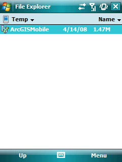

  1. Open the file browser on the device and navigate to where you have copied the CAB file. You can place the CAB file anywhere on the mobile device or on a storage card inserted into the device. Note that you cannot run the CAB installer from a Windows XP or Windows Vista machine.
  2. Tap the CAB file with your stylus or highlight the CAB file and press down on the rocker to start the installation.

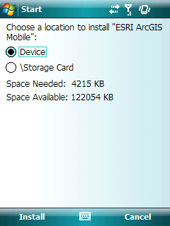

  3. You will be asked to choose where you would like to install the application (on the device or on a storage card). You can install the ArcGIS Mobile application on any storage mechanism on the device. However, if you consider installing onto a storage card, consider how the storage card will be used an if the card is dedicated to use with the mobile device.

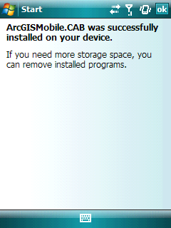

  5. Once the install is complete, press Ok to finish.
When the install of the application is complete, a new entry will appear in the Programs Group titled ArcGIS Mobile. Tap on it to start the ArcGIS Mobile application.
