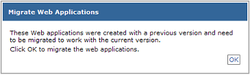

When you navigate to the Web Applications page in Manager after installing 9.3, you'll be prompted to migrate all of your Web applications. This migration step is required for your Web applications to run at 9.3. Simply click OK to migrate your Web applications.
Migration dialog

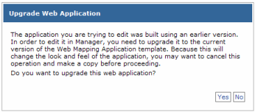

In order for Manager to edit a migrated Web application, you have to allow Manager to upgrade the application so that it adopts the 9.3 look and feel of the Web Mapping Application. You do this by simply editing the Web application in Manager (by clicking the Edit button). Manager will display the following message allowing you to verify that you want to upgrade your application.
Upgrade dialog
By separating the upgrading step from the migrating step, you can control if and when the users of your Web application are ready to work with the enhanced look and feel of the new Web Mapping Application. If you decide not to upgrade your Web application, you can still use Visual Studio to edit it. Note that upgrading is only available for Manager created Web applications.

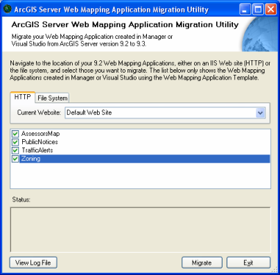

If you built your Web applications using the Web Mapping Application Template inside of Visual Studio, you can migrate them using the Web Mapping Application Migration Utility. The migration utility can also migrate Web Mapping Applications that you've customized, for example, adding additional Web controls. To open the utility click Start > All Programs > ArcGIS > ArcGIS Server for the Microsoft .NET Framework > Web Mapping Application Migration Utility.
Migration utility
By default, the utility will list all the Web Mapping Applications on the Web site that need to be migrated. This utility will also list Web applications created in Manager and allow them to be migrated as well.
