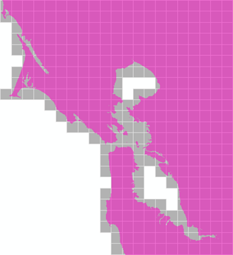

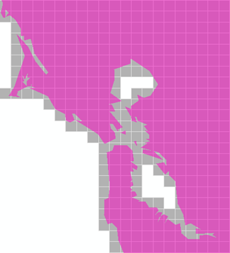

The images below show how very similar sets of tiles get created whether you use a detailed or a generalized feature class. The second feature class has had most of the vertices removed using the Simplify Polygon tool. The gray squares represent a 4096 x 4096 supertile at about 1:4500.

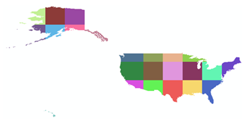

Caching by feature class not only saves you space, it can also help you track the status of your cache. By default, the caching tools report the OID of the feature being cached. After you dissolve your feature class as described above, you might cut it into a few regions so that you can still track the status.
One effective way to do this is to make a grid with the Create Fishnet tool and clip it to your feature class boundary. You can keep a copy of the clipped grid open in ArcMap and follow along as the caching tools report "Processing feature with OID = 8", "Processing feature with OID = 9", and so on.
If you're caching at some very large scales, you might include more cells in the grid to get a more fine-grained idea of the status. Just remember that the caching tools restart for each feature and you'll get double tile creation along feature boundaries. The more cells you use, the longer the caching will take. For that reason you might want to do some manual post-processing on your gridded feature class to merge some of the smallest features with their larger neighbors.
