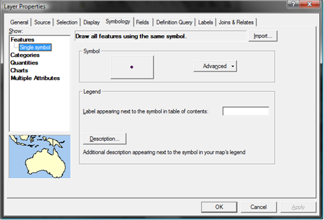

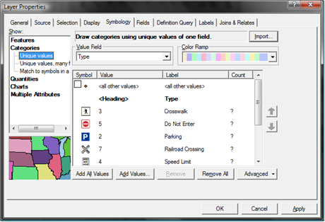

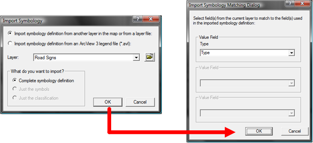

  3. Double-click the Road Signs layer in the Table of Contents in ArcMap and click the Symbology tab.

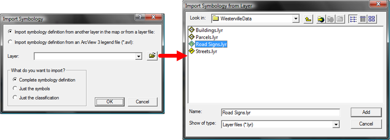

  4. On the symbology tab, click on Import... and click Open to navigate to the layer files and import the symbology.
  5. For the Road Signs layer, choose the field Type as the primary field used by the unique value renderer.
  6. Click Ok on the Layer Properties dialog box to set the new rendering scheme for the layer.
  7. The Road Signs layer uses a unique value renderer to identify each of the feature types that can be collected in the ArcGIS Mobile application. The legend item for each value in the renderer is the name assigned to the feature type. Once you have successfully changed the symbology for the Road Signs layer, alter the symbology for the remaining layers following the above steps.

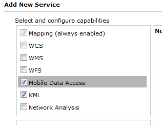

  4. Click Next to move to the second panel of the wizard. Notice that the Mapping capability is enabled by default. Here you will need to check on Mobile Data Access. This will create a new web service endpoint that the ArcGIS Mobile application will connect to in order to synchronize data.

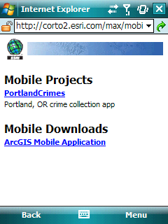

To install the application, open Internet Explorer on your Windows Mobile device and navigate to http://<web_server>/arcgis/mobile.
On the web page, click the link titled Click to download the ArcGIS Mobile Application and start the installation on your device.
Note: You must first have established a network connection on your Windows Mobile device to the location of your web server. Please follow the device instructions for establishing a desktop passthrough connection using ActiveSync for Windows XP or Windows Mobile Device Center for Windows Vista. Your Windows Mobile device must also meet the system requirements for ArcGIS Server - it must be running Windows Mobile 5 Pocket PC Edition or Windows Mobile 6 Professional and already contain the update for CompactFramework 2.0 SP2.

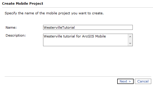

  1. In Manager, click the Applications tab and click Create Mobile Project. A wizard appears that helps you create the project.
  2. Type a name and description for your project. This name will appear in both the project web page and the project web service. Click Next to continue.

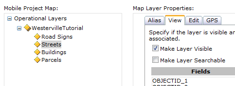

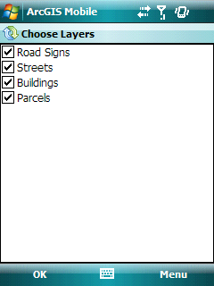

  4. Next, you can set properties for each map layer in the mobile service. This will define the behavior of the tasks in the ArcGIS Mobile application. Assuming that you followed the earlier step of adding the Global ID column to the Road Signs layer, that should be the only map layer that is checked as editable on the editing tab. For this step, select the Road Signs layer and click each tab in the Map Layer Properties to display its current behavior in the project. Do not change anything. The Road Signs layer should be viewable, searchable and editable in the project. It will also have default settings for GPS data collection in the GPS tab. The searchable property determines whether or not the layer will appear in the Search Features task. The editable property determines whether or not the layer will appear in the Collect Features task.
  5. For the other layers (Streets, Buildings, and Parcels), uncheck the searchable property as you will only want to be able to collect and search for road sign features in the tutorial project.

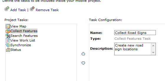

  6. The final step is to establish what tasks are to be used in the project. You can rename each task and provide a brief description. The tasks chosen will appear on the tasks page in the field project. Each task should contain a name and description that best suits both the task that needs to be accomplished in the field and the verbage used by the field worker.
  7. Click the Collect Features task and type a more meaningful name for the action that will be performed in the project. For example, change the name from Collect Features to "Collect Road Signs".
  8. For each of the other tasks, feel free to change the name and description. For example, change Search Features to Search Road Sign Inventory.
  9. When you are finished renaming the tasks, click Finish to complete the wizard and create the new project. This will return you to the Mobile projects catalog. Here you can edit an existing project

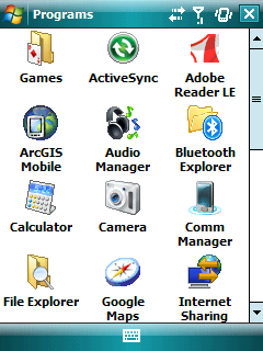

Before you start, you need to open the ArcGIS Mobile application on your Windows Mobile device. From the Start menu, click Programs. In the programs list you will find ArcGIS Mobile. Click on ArcGIS Mobile to start the application.

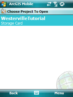

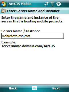

  1. The first step in using the application is to choose a mobile project to work on. Mobile projects are stored locally on the device on either in main memory or on a storage card. You can download projects from the web server you create new projects on. To do so, click Download Project... from the Choose Project page.
  2. Downloading a project is a two-step process. The first step is to locate the web server that contains mobile projects. Type the name of the web server that contains the WestervilleTutorial project that you created earlier.
  3. When you have entered the name, click Next to continue. Note that if you cannot connect to the web server, ensure that your device is properly connected to the internet. A quick method of testing your connection is to use Internet Explorer. If you cannot access the web server using Internet Explorer on the device then you will not be able to download the project either.

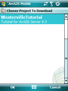

  4. A list of published mobile projects that have been created on the web server will appear after you click next. Pick the WestervilleTutorial project using your stylus or by pressing down on the rocker.

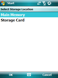

  5. Once you choose the WestervilleTutorial project, you will be prompted as to where you would like the mobile project to be stored - either on the main memory of the device or on a storage card. Once you pick the location, the project will be downloaded to your device. A new folder will be created at \My Documents\ArcGIS Mobile\ called WestervilleTutorial. Inside this folder is where the project file will be stored (WestervilleTutorial.amp).
  6. Once you have chosen the storage location for the WestervilleTutorial project that you download from your web server, you are returned to the Choose Project page where you can then click on the WestervilleTutorial project to open it.

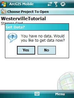

Now that you have downloaded and clicked the WestervilleTutorial project from the Choose Project page, you will be guided through the process of synchronizing data from the web server to your device.

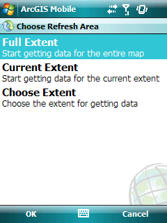

  1. Click Yes to get data from the server. When you open a project for the first time it will create a folder structure on your device to store map data from the server. The application will then ask you to choose which layers you would like to get data for. Check each layer in the list and click Next.
  2. You will then be prompted to choose the extent of data you want to receive. Tap on Full Extent to receive all data from the server. This will start the synchronize request with the server. Once it is complete, you will be notified if it is successful or if there were errors fulfilling the request.

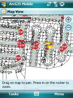

  3. If you then press the left soft key, Map, or choose the View Map task, you can display the map data that you just received from the server.

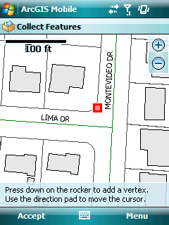

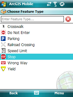

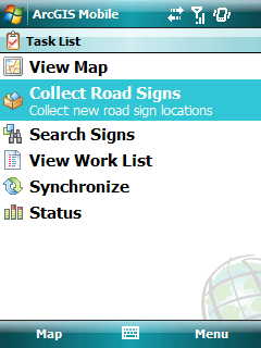

  1. Click Collect Road Signs from the list of tasks on the Tasks page.

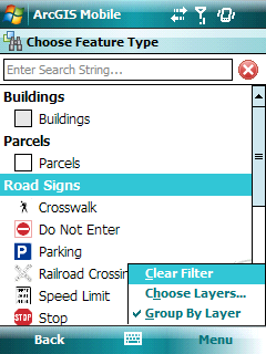

  2. Choose the feature type Stop by scrolling down the list using the rocker or tapping Stop using the stylus. Once you pick the Stop feature type, you are ready to collect a new stop sign feature.
  3. Once you have chosen a feature type, the map page will appear so that you can locate the shape of the new stop sign. By default, the map page is in a mode where you can simply tap on the map with your stylus to create the location of the Stop sign. However, the map may not be centered at the proper location or it may be zoomed in too close or out too far. If you are at the right scale, you can simply use the directional pad on the rocker to move the cursor. When the cursor reaches the edge of the map display, it will automatically pan in that direction. Also, you can zoom in or zoom out on the map by pressing the right soft key menu and pressing Zoom In command or the Zoom Out command.
  4. Tap on the map to set the location of the new stop sign. You will see the current location appear as a red rectangle on the map. If you tap on the map again you can change the location that you just set.
  5. The method that you just used to set the location of the stop sign is "Collect Using Stylus". You can change the collection method from the Collect menu. Other options include Collect Using GPS and Collect Using XY Coordinate. Also, you can offset the location that you set by pressing the Menu soft key and clicking the Offset Location command from the menu.
  6. Press the left soft key to Accept the location you have specified. Note that you can change the collection method from the Menu soft key.

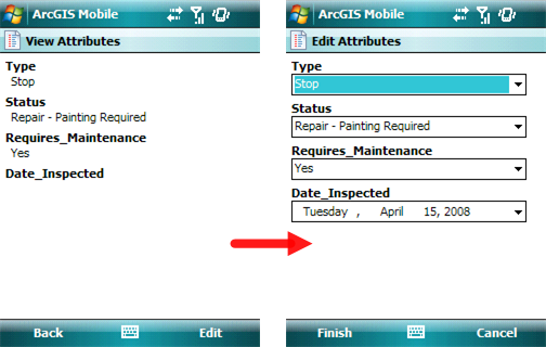

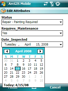

  7. The final step of the collection process is to set attributes for the new feature. Fields that contain business rules (domains) present a drop-down list of valid values for you to choose from. Date fields provide a date picker to choose the correct date from.
  8. Set the Status, Requires_Maintenance, and Date_Inspected field values to see how different field types display values for a feature.
  9. When you are done setting attribute values, press the Finish soft key to complete the collection workflow. This will return you to the Choose Feature Type page so that you can collect a second feature. To return to the Task menu, press the Back soft key.

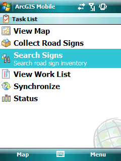

Update existing features using the Search Signs task
Using the ArcGIS Mobile application you can create new features using your stylus or a GPS receiver or by entering XY coordinates with the Collect Features task. You can also update the attributes of existing features. In order to update existing features, you must first search for them using the Search Features task.
  1. Before you can update a feature, you must find it. When creating the mobile project, you named the Search Features task Search Signs. Tap on the Search Signs task in the Tasks menu to find features to update.
  2. The Search task guides you through the process of searching for features - just like the Collect Features task does. You can search for features in a feature type or you can search against all features in a layer. The layers that you can search against were set when you defined the project by checking or unchecking whether or not the layer was searchable.

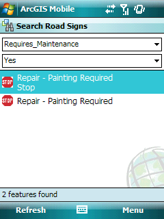

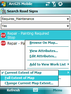

  3. To search against all features in the Road Signs layer, check Group By Layer from the Menu soft key. This will sort the list of feature types based upon the layer they belong to instead of alphabetically. You can then click the bolded Road Signs entry in the list to search against all features in the signs layer.
  4. Next you can set search criteria. From the <All Text Fields> drop-down list, choose the Requires_Maintenance field so that you can search for all signs that require maintenance. For the value field, click Yes. Note that depending upon the field chosen that a different value control will appear. For a boolean field such as Requires_Maintenance, a drop-down list gives you the choice of yes or no.

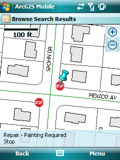

  5. Press the Find soft key to perform the search for road signs that require maintenance.
  6. You can change the search area from the Menu soft key. Press the Menu soft key and choose Full Extent to change the search area. Note that the number of results you receive is dependent upon the search area that you specified.

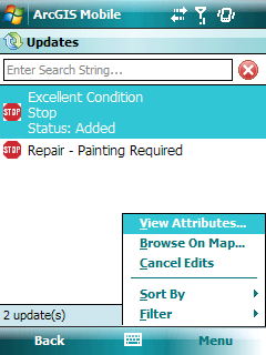

  7. The search results are sorted based on the features' distance to you. You can perform different actions against features in the list. You can directly view the attributes of a feature in the list by tapping a feature in the list. You can also browse the list of features using the map. To do this, press Browse Features... from the Menu soft key.
  8. You can browse each feature by pressing the up or down arrow on the directional pad of the rocker. The information bar displays the feature type and the value of the primary display field of the feature. As you move between features, the map will pan to include the browsed feature on the display. Point features (like road signs) will be highlighted using a pin.
  9. Press down on the rocker to view all the features' attributes. This will open the View Attributes page. You can move up and down the page using the directional pad of the rocker. This can be useful if you need to view a lot of field values. Next, press the Edit soft key to open the Edit Attributes page.
  10. Here you can change one or more attribute values and then press the Finish soft key to complete your attribute update.

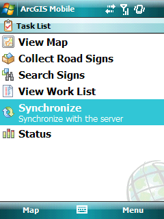

In the previous two sections of this tutorial, you created a new feature and updated an existing feature. With updates complete, you can synchronize your changes back to the server. Using the ArcGIS Mobile application, you are in complete control of the synchronization process.

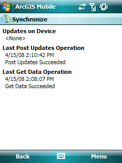

  1. From the Task page, tap on the Synchronize task.
  2. The first section of the page displays the current status of the features that are on your device. If you collected one feature and updated one feature, then this will be recorded by the status on this page. If you would like to see more detail regarding the updates on the device, you can click View Updates... from the Menu soft key. From the updates list, you can choose to Cancel Edits for a selected feature.
    To post updates back to the server, press the Menu soft key, tap the Synchronize menu, then click Post Updates. This will start the synchronization back to the server. When the synchronization is complete, the status page will be updated with the post results.
