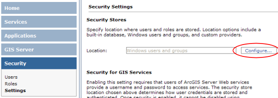

  2. In Manager, expand the Security panel and click Settings.
  3. Click the Configure link.

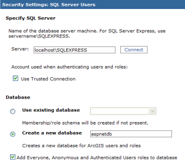

  5. In the dialog for specifying settings for SQL Server, enter the database server name in the Server text box. You may use "localhost" if SQL Server Express is installed on the local computer. For SQL Server Express, add "\SQLEXPRESS" to the end of the name, for example, localhost\SQLEXPRESS.
  6. Click Connect to display a list of available databases and options (if the connection fails, check to ensure your database server is running and available on the network, and that the account you used to log into Manager is allowed to administer the SQL Server).
    Security Settings wizard: SQL Server connection
  7. If using SQL Server Express, verify that the option to Use Trusted Connection is checked. This means that applications will use the account that runs ASP.NET to authenticate users and to check roles. If using the full version of SQL Server, and the SQL Server is installed on a separate machine, uncheck the Use Trusted Connection option, and enter a SQL database login. For full SQL Server on the same machine, the trusted connection option is recommended, but a SQL login may also be used.
  8. Click the option to Create a new database, and enter a name (such as aspnetdb). Verify that the option is checked to "Add Everyone, Anonymous and Authenticated Users roles to database". Then click Next.

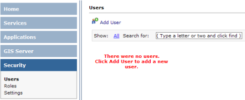

  1. In Manager, click the Security tab on the left side, then click Users. No users will be listed if you just created the database by following the steps above.
    Users list dialog

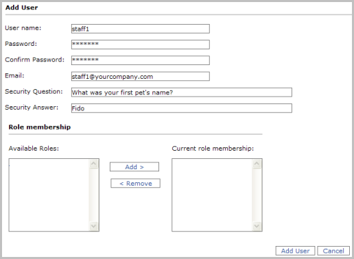

  2. In the Users panel, click the Add User link to display the dialog for adding a new user.
  3. In the new-user dialog, enter the information for the new user. The following is a suggestion, but you may enter your own user settings. Note: by default, passwords must have at least seven characters, and at least one character must be non-alphanumeric (such as @, #, $, or %; but avoid using &).
    • User name: staff1
    • Password: staff1$
    • Email: staff1@yourcompany.com
    • Security Question: What was your first pet's name?
    • Security Answer: Fido
      Add user dialog
  4. No roles have been defined yet, so leave that aspect blank. Click Add to add the new user. Manager should return to the Users list and display the new user.

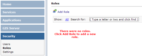

  6. Click the Roles link in the Security section. No roles will exist yet.
    Roles list

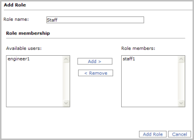

  7. In the Roles panel, click the Add Role link to display the dialog for adding a new role.
  8. In the new-role dialog, enter a name for the role, such as Staff. Then highlight the user you created earlier, such as staff1, and click the Add> button to add it to the Role members list.
    Add role dialog
  9. Click Add Role to add the role and return to the Roles list. The new role should appear in the list.

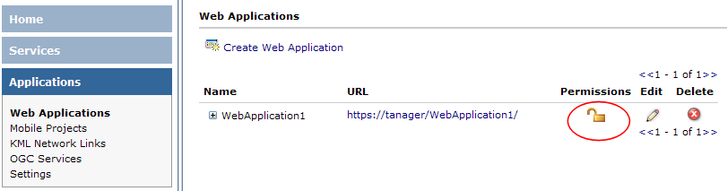

  2. In Manager, click Applications to list the Web applications. Find the application you want to secure in the list. In the Permissions column, you will notice the unlocked icon Unlocked icon for unsecured application. This indicates that the application is not restricted, so that users currently are not required to log in.
    Applications list dialog
  3. Click the permissions icon Unlocked icon for unsecured application, which displays the Permissions dialog for the Web application.

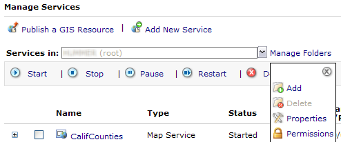

  2. Add a folder to your server's services by clicking Manage Folders, and in the drop-down list that appears, clicking Add.
    Add a service folder
    In the Add Folder prompt, enter a folder name such as SecureServices. Click OK to add the folder.

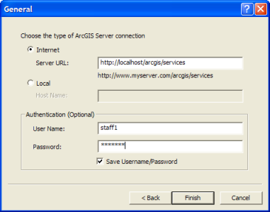

  8. In the next panel, click the Internet type of connection, then enter your server's URL, for example, http://myserver/arcgis/services. For this connection, leave the Authentication dialog blank. Click Finish.
  9. The dialog closes and a new connection should appear in your GIS Servers list, such as "arcgis on myserver". Expand this node. You should see the service at the root of your server. However, the folder that you secured in the previous connection (SecureServices) should not be visible. Since you permitted the Everyone role to access the root folder, services in the root and any folders that did not override its settings will be visible to all users, even without a login. Since you did not connect with an appropriate login, the SecureServices folder is not available to this connection.
