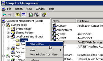

  1. To add users and groups to the local Web server, go to Start - Control Panel - Administrative Tools - Computer Management (alternatively, right-click on the My Computer icon on the Desktop, and click Manage). In the Computer Management console, expand if necessary the System Tools and then Local Users and Groups. Click the Users folder to view the list of users.
    • In Windows Vista or Server 2008, go instead to Start - Control Panel - Administrative Tools - Server Manager. In the Server Manager, expand Configuration and then Local Users and Groups. Click the Users folder to view the list of users.
  2. Right-click on the Users folder and choose New User... The New User dialog opens.
    Computer Management - Adding new user
  3. Enter the user name, for example, walkthrough1. Enter a password and confirm it (for example, walkthrough1). You may uncheck the requirement that the user must change password at next logon. Set other options as desired, then click Create.
  4. Add at least one other user, for example, walkthrough2. Close the New User dialog.

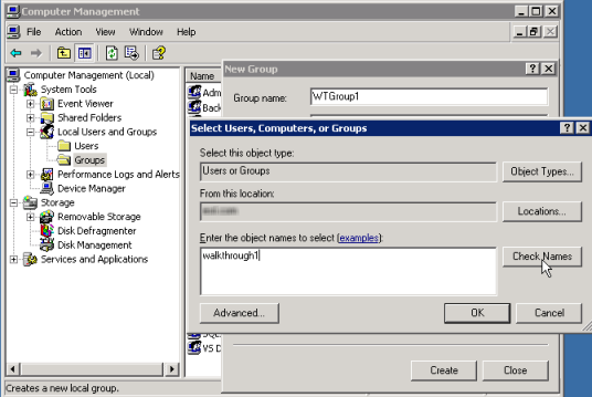

  5. Right-click on the Groups folder in the Computer Management (or Server Manager) tree, and choose New Group... The New Group dialog opens.
  6. Enter the group name, for example, WTGroup1. Optionally add a description. To add members to the group:
    • Under the Members area, click Add... The Select Users, Computer or Groups dialog opens.
    • In the Select Users dialog, click the Locations... button, and in the popup dialog, select the local computer's name and click OK.
    • Back in the Select Users dialog, under the Enter the object names to select box, type the name of the first user added above (walkthrough1).
      Computer management: adding new group
    • Click Check Names to verify the user exists (if necessary, click the Advanced button, then Find Now to list all users; you can select the user from this list).
    • Click OK to close the Select Users dialog and return to the Add Group dialog. The New Group dialog now lists the user you selected.
  7. Click Create to create the new group.

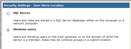

  3. Click the Change button (do this even if the Location already indicates Windows users and groups; the wizard performs additional essential configuration steps).
    Security Settings wizard: Change
  4. In the dialog that opens for location for Users, choose Windows users.
    Security Settings wizard: set Windows users
    Click Next.

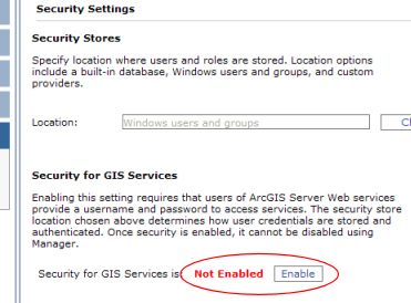

  5. In the panel for Role store location for users, click Windows groups. Click Finish. The wizard will dismiss and the Location box will read Windows Users and Groups.
Notice that security for services is set to Not Enabled. Do not enable security at this point. You will enable security in the last step in this walkthrough. Enabling security is the last step because you first need to set permissions for your Web services. Once security is enabled, only users whose roles you have permitted can access the GIS Web services.

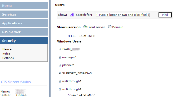

View Users and Roles
When your users and roles are Windows users and groups, you may view them in Manager. To add, edit or delete users or groups, you must use Windows operating system tools, as described in the first section of this walkthrough.
  1. In Manager, click the Security tab on the left side, then click Users. The Users panel will display a list of users on the local Web server.
    List of Windows users in Manager
  2. If you have more users than can be displayed in a single panel, click the >> to display additional users. You can also enter part or all of a user name in the Show: box near the top of the panel and click Find to filter the list of users.
  3. To view a user's group membership, click the plus symbol next to the name. The list will show the groups of which the user is a member on the local system.
  4. If the computer is a member of a domain, you can view users on the domain by clicking the Domain radio button for Show users on. You can then view domain group membership for these users (the list will not show membership in local system groups).

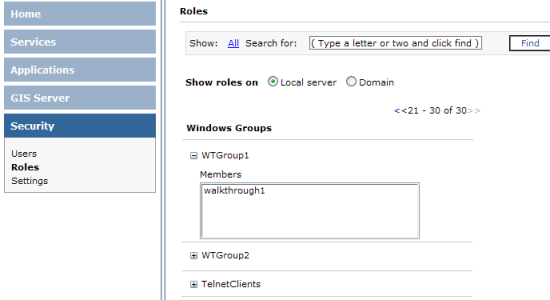

  5. View roles by clicking Roles in the Manager Security tab. In this case, the list displays Windows groups on the local Web server. If the computer is a member of a domain, you may click Domain to see groups in the domain. You can page between lists of groups or filter/search for groups as with the Users dialog.
    List of Windows groups in Manager
  6. Click the plus button next to a group to view the users who are members of the group.

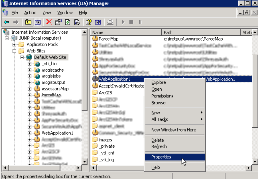

  8. Set the authentication method for the application using IIS Manager:
    1. Open IIS Manager by going to Start - Settings - Control Panel - Administrative Tools - Internet Information Services Manager.
    2. Expand the left-hand tree of IIS Manager, under Web Sites or Sites, to find Default Web Site, then expand Default Web Site to find the Web application you just secured.

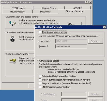

    3. On Windows XP or Server 2003:
      (1) Right-click on the Web application and click Properties in the context menu. The Properties dialog opens for the application.
      IIS Manager: application properties
      (2) In the Properties dialog, click the Directory Security tab. In this panel, under Anonymous access and authentication control, click Edit... The Authentication Methods dialog opens.
      (3) In the Authentication Methods dialog, uncheck the Anonymous access box. Then check at least one of the methods under Authenticated access. For the demonstration purposes of this walkthrough, you may choose Basic authentication (click Yes if a warning message appears). For more information on authentication methods, see the Security Overview page.
      Application authentication methods
      (4) Click OK to dismiss the Authentication Methods dialog and return to the application's Properties dialog.

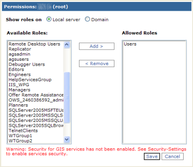

  4. Set permissions on the root folder to allow anyone in the Users group to access services. This approach is appropriate if you wish by default to allow all users, but then will restrict certain services or folders to require a valid login. To set this permission, ensure the Services in: box reads "Server name (root)", where Server name is your server's machine name (click the drop-down list to select this item if necessary). Then click Manage Folders, and in the drop-down, choose Permissions. The permissions dialog that opens should display the folder name (root).
  5. In the Permissions dialog, select the Users role (group), then click Add>. The Users role moves to the Allowed Roles list. The Users role typically covers all users with accounts on the local server. Optionally, if you have users on the Windows domain that you wish to allow, you may add them by clicking the Domain option at the top of the list (the Domain Users group typically includes all users in the domain). Note the warning that security for services is not enabled; we will enable security in the next section. Click Save to save the permissions list.
    Setting service permissions
  6. Restrict permissions on the folder you created earlier. In the Services in: list, use the drop-down to select the folder (SecurityWalkthrough). Then click Manage Folders and then Permissions.
  7. In the Permissions dialog, click the Users role in the Allowed Roles list, then click <Remove. The role is moved to the Available Roles list. If you added other roles (e.g., Domain Users), remove them as well. Next, click a specific role to allow, from either the local server or the domain, such as WTGroup1. You can add multiple roles as allowed if desired. Click Save to save the permissions list.

  1. In Manager, click the Security tab on the left, then click Settings within the Security section. This displays the settings panel for security.
  2. In the Security Settings panel, read the information under Security for GIS Services. Notice that security is set to Not Enabled when you install ArcGIS Server.
    Enable security for services
  3. Click Enable. A warning dialog opens cautioning you to set permissions before enabling security for services. Click the Enable Security for Services button to confirm. The dialog returns to the Security Settings panel, and the indicator now shows that security is enabled.

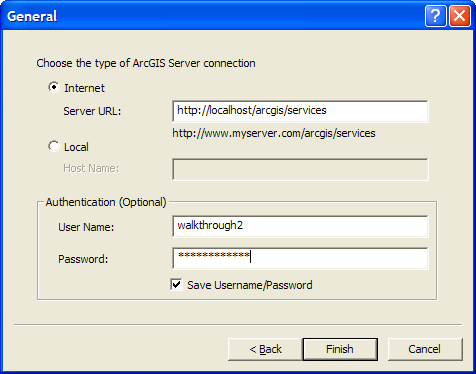

  5. To verify that security for services is in effect, use ArcCatalog to connect to your services. Start ArcCatalog, either on your local machine or on a machine that can access the Web server for your ArcGIS Server.
  6. In ArcCatalog, expand the GIS Servers node in the Catalog tree. Double-click the Add ArcGIS Server item. The Add ArcGIS Server dialog opens.
  7. In the dialog, click Use GIS Services. Click Next.
  8. In the next panel, click the Internet type of connection, then enter your server's URL, for example, http://myserver/arcgis/services. In the Authentication part of the dialog, enter the user name and password for an account that is in the Users group, but not in the WTGroup1, for example, walkthrough2 (or if you configured security with different users and roles, use an account that does not permission to the secured folder, SecurityWalkthrough). Click Finish.
    Connecting to secured services in ArcCatalog
  9. The dialog closes and a new connection should appear in your GIS Servers list, such as "arcgis on myserver". Expand this node. You should see the service at the root of your server. However, the folder that you secured in the previous connection (SecurityWalkthrough) should not be visible. Since you permitted the Users role to access the root folder, services in the root and any folders that did not override its settings will be visible to all Users. Since you did not connect with an appropriate login, the SecureServices folder is not available to this connection.
