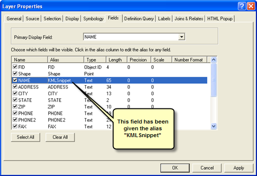

If you choose to use snippets, they derive from a field in your data. You choose which field appears in the snippet by giving it the alias "KMLSnippet". You can only give one field this alias.

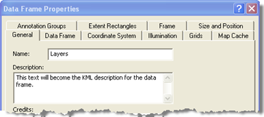

The description for the data frame is based on what's in the Description box on the General tab of the Data Frame Properties dialog box.

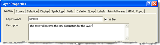

The description for layers is based on what's in the Description box on the General tab of the Layer Properties dialog box.

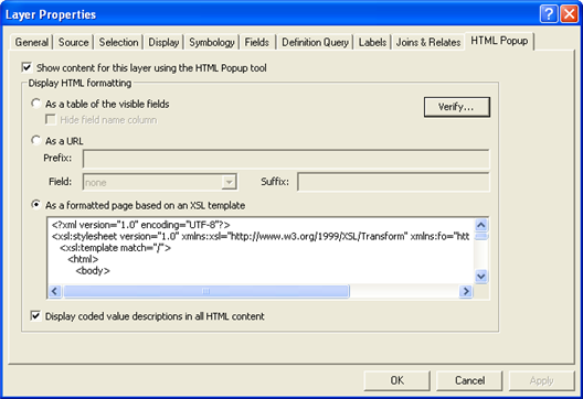

The description for individual features is formatted by the XSL stylesheet that you specify on the HTML Popup tab in the Layer Properties dialog box in ArcMap. Some sample stylesheets are included in <ArcGIS Install location>\Styles\HTMLPopup.
XSL stylesheets allow you to use your feature attribute values to construct a popup window with any HTML. For example, you could create a link to a geoprocessing task result that returns KMZ, using the attribute values to define the model parameters. This allows you to access real GIS in a KML browser environment. You can also link to the results of layer queries in a similar way, using attribute values as query parameters. Additionally, you can display images or Flash videos referenced by an attribute in your feature. In summary, you can link to any HTML content on the Web.
