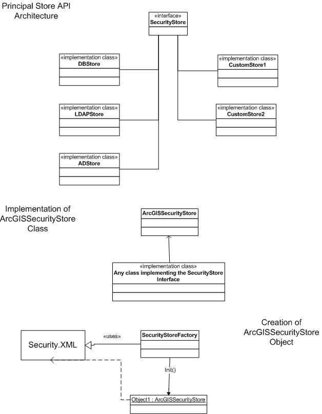

Principal Store API architecture
Please refer the diagram to understand the API architecture. Also refer to the JavaDoc for the Principal Store API.
The Security.XML file contains configuration parameters (as key value pairs) for the various stores. The SecurityFactory class used within the manager creates objects of type ArcGISSecurityStore with a particular implementation. The SecurityFactory class calls the init method on the implementation of ArcGISSecurityStore and passes a hash map of all the configuration parameters from the Security.XML. You can implement the 'init' method to read the configuration parameters that your class needs to initialize itself.
