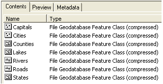

A compressed feature class or table looks the same as when it was uncompressed, but you can tell whether data is compressed by listing feature classes and tables in the ArcCatalog Contents tab. A compressed feature class or table has "(compressed)" in the Type column.
The ArcCatalog Contents tab reveals whether a dataset is compressed
Another way you can tell is by opening the Feature Class or Table Properties dialog box. The General tab states whether the data is compressed.
