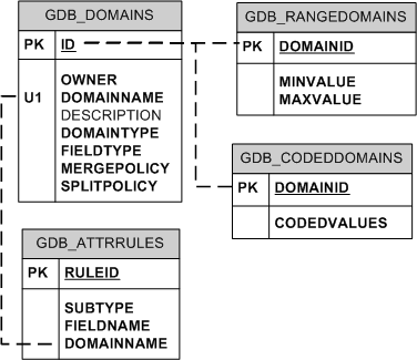

Domains in a DB2 DBMS
In the database, domains are stored in the system tables GDB_DOMAINS. Coded domains are tracked in the GDB_CODEDDOMAINS system table, and range domains are tracked in the GDB_RANGEDOMAINS system table.
The GDB_FIELDINFO system table stores one record for every field in every user-defined table in the geodatabase. This table also stores the name of the domain (if any) that is associated with each field.
The GDB_ATTRULES table stores the name of a field, the name of the domain associated with that field, the subtype code for the feature class, and the rule ID.
The following are the domain system tables. Dashed lines indicate an implicit relationship between tables.
System domain tables in DB2
