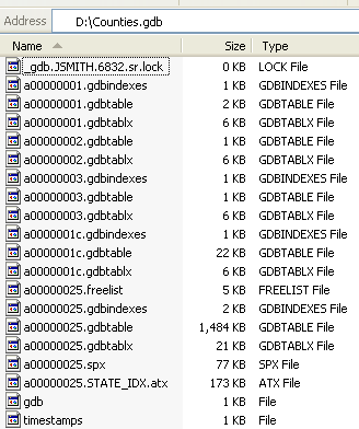

A file geodatabase stores as a folder of files. When you view the folder with Windows Explorer, apart from the .gdb extension, it looks like any other folder and you can view its contents. The folder contains cryptically named files that hold geographic data, attribute data, index files, lock files, and a signature file as well as other files. Each feature class or table in the geodatabase is stored in two or more files. By design, it is difficult, if not impossible, to tell which files make up any given dataset.
When you access the folder and its contents with Windows Explorer, several Windows commands are available. Although not recommended, some users will inevitably attempt to use some of these commands. This topic discusses what operations can and cannot be performed safely with Windows Explorer.
