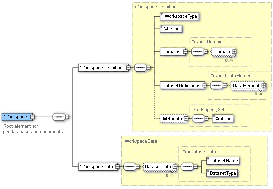

The XML Workspace document contains two elements: WorkspaceDefinition and WorkspaceData.
Using the WorkspaceDefinition and WorkspaceData, workspace documents will contain the schema of a geodatabase and, optionally, data from its tables. Having the definition separated from the actual data offers a few benefits. A software agent can read only the definition section of the document to discover what it contains, and by making the data section optional, a workspace document can be used to transfer only schema information.
In the case of tables and feature classes, the name of the data element in the definition section corresponds to the name of the table data in the data section. Other datasets, such as topologies, geometric networks, or feature datasets, appear only in the definition section (no data is exported for them).
