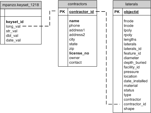

Its name includes the name of the user who caused the keyset table to be created and the process identification number of the user's session. The format is as follows:
<owner>.keyset_<process_id>
The keyset tables store a keyset ID number for each selection set and values for the field on which the relationship between the feature classes is based.
Because it is a temporary table, the keyset table is deleted when the user disconnects from the database.
The following is a keyset table for a selection made between the related tables laterals and contractors. In this case, the long_val field would be populated and contain the values of the contractor_id field on which the relationship class between laterals and contractors is based.
Keyset table and associated business tables in Informix
The following is the definition for a keyset table in Informix:
Field name Field type Description
keyset_id Int Identifier for the keyset selection
NOT NULL
long_val Int Value of the field on which the relationship class is based, if that field is a number field
str_val Varchar(255) Value of the field on which the relationship class is based, if that field is a string field
dbl_val Double precision Value of the field on which the relationship class is based, if that field is a double precision field
date_val Datetime year to second Value of the field on which the relationship class is based, if that field is a date field
