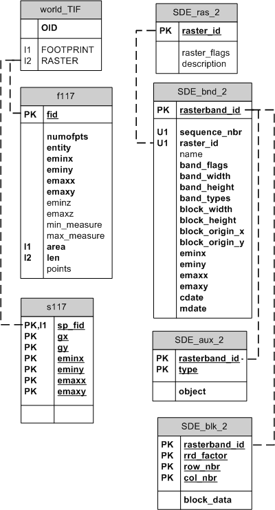

Raster tables in a SQL Server DBMS
ArcSDE geodatabases in a SQL Server DBMS store raster data in SQL Server's native binary format, which is similar to the way it stores compressed binary feature classes. A raster column is added to a business table, and each cell of the raster column contains a reference to a raster stored in a separate raster table. Therefore, each row of a business table references an entire raster.
When you import a raster into an ArcSDE geodatabase in SQL Server, a raster column is added to the business table of your choice. You can name the raster column whatever you like, so long as it conforms to SQL Server's column naming convention. ArcSDE restricts one raster column per business table.
A raster dataset is made up of seven tables: the business table, feature table, spatial index table, auxiliary, block, band, and raster attribute tables. The following are the business and raster tables for a raster dataset called world_TIF. Dashed lines indicate an implicit relationship between tables.
Tables of a raster dataset in SQL Server

Raster catalogs and datasets are tracked in the system table GDB_RASTERCATALOGS. Like other types of data, raster catalogs and datasets are also tracked in the GDB_OBJECTCLASSES and SDE_layers tables. Columns of type raster are tracked in the SDE_raster_columns table—there is one entry for every table containing a raster column. The layer_id from the SDE_layers table provides the number in the raster tables. In the example accessed by clicking the link below, this number is two and is appended to the SDE_ras, SDE_bnd, SDE_aux, and SDE_blk tables. The example contains the raster dataset tables and system tables of the world_tif raster dataset. (You will need Adobe Acrobat Reader to open the diagram.)
SQL Server raster dataset diagram
The database name fields in the GDB_OBJECTCLASSES, SDE_table_registry, SDE_column_registry, SDE_raster_columns, and SDE_layers table all contain the same value, but to keep the diagram from being too cluttered, the implicit relationship between these fields is not shown. Similarly, the owner fields in all these tables also contain the same value, though the relationship is not drawn on the diagram.
