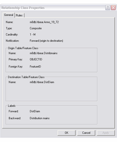

You can view information about relationship classes by right-clicking the relationship class and clicking Properties to open the Relationship Class Properties dialog box.
Relationship Class Properties dialog box in ArcCatalog
This shows the Distribmains feature class participates in a one-to-many relationship with the DistDiam annotation feature class. The records in the tables are joined based on the ObjectID in the Distribmains feature class and the FeatureID in the DistDiam feature class. This is a composite relationship class, which means changes in one table affect or alter features in the related table. In this case, changes made to the origin class (Distribmains) triggers a change in the destination feature class (DistDiam). This is referred to as Forward notification.

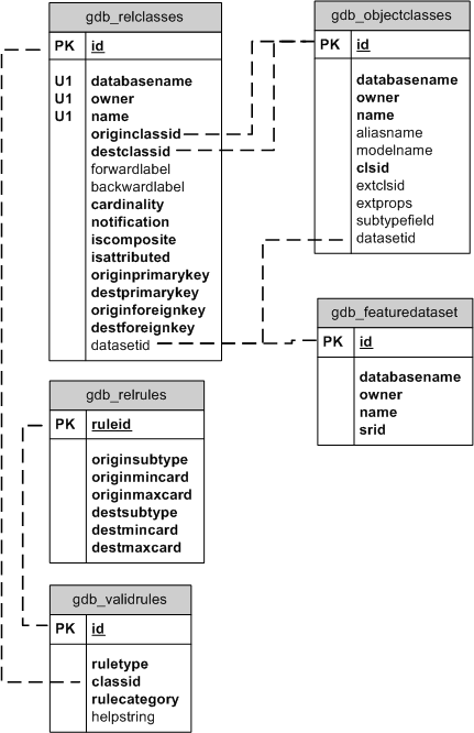

Relationship classes in a PostgreSQL DBMS
Relationship classes with a cardinality of one to one and one to many do not require a new table to be created in the geodatabase to store the relationships. All the system metadata required to manage the relationship is stored in the gdb_relclasses system table. The rules that are defined for the relationships are stored in gdb_relrules.
Relationship class system tables in PostgreSQL
