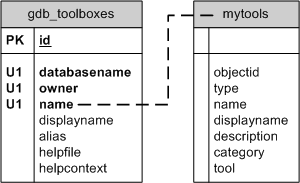

Only two tables are needed to represent toolboxes in a database: a business table to store information about the tools in the toolbox and a system table—gdb_toolboxes—to keep track of the toolboxes. The following are the tables for the mytools toolbox:
Tables for the MyTools toolbox in PostgreSQL
These two tables are associated by the name—the value in the name field of the gdb_toolboxes table corresponds to the business table name.
The gdb_toolboxes table resides in the ArcSDE administrator's schema, and the business table resides in the user's schema. The gdb_toolboxes table is created when you create the geodatabase; the business table isn't created until you create the toolbox.
