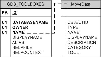

Only two tables are needed to represent toolboxes in a DBMS: a business table to store information about the tools in the toolbox and a system table—GDB_TOOLBOXES—to keep track of the toolboxes. The following are the tables for the MoveData toolbox:
These two tables are associated by the Name—the value in the Name field of the GDB_TOOLBOXES table corresponds to the business table name.
As indicated by the names in parentheses following the table names, the GDB_TOOLBOXES resides in the ArcSDE administrator's schema (sde) and the business table resides in the user's schema (RJP). The GDB_TOOLBOXES table is created when you create the geodatabase; the business table doesn't get created until you create the toolbox.
