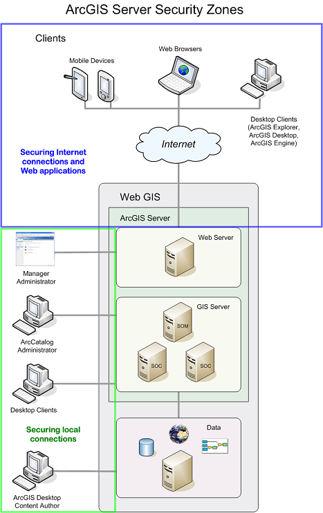

You can think of ArcGIS Server security in terms of two "zones", shown in the graphic below. This section of the help contains books that correspond to the zones.
All GIS server administrators need to be concerned with the local security zone because administering the server requires an account that has been added to the agsadmin group. You can immediately start configuring local security by adding or omitting users from the agsadmin and agsusers groups. In contrast, Internet security requires that you do some preparatory work of configuring a user and role store and explicitly enabling security before you can prevent users from accessing your Web applications and services.
The users of your GIS server will determine where you focus your security strategy. If you have a Web application or service that exposes various levels of access to anyone with an Internet connection (for example, Guest, Employee, Administrator), you need to be concerned with the Internet security zone, namely, setting up users and roles and a way of storing these. In contrast, if you have a set of services that only users on the local network will be adding to ArcMap, you only need to be concerned with the local security zone, configuring the agsadmin and agsusers groups.
Some applications require attention to both zones, such as a Web application used by employees on your LAN for editing GIS data. The application needs to run as a member of the agsusers group, involving the local security zone. At the same time, access to the application needs to be managed through users and roles, involving the Internet security zone.
