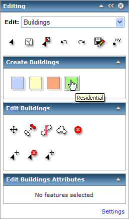

Use symbols based on unique values if you want the user of the Editor task to quickly choose the feature type to create. The symbols from the unique value renderer are reflected on the Editor task buttons.
The above image shows what the Editor task looks like when the Buildings layer of the map has a unique value renderer applied. The renderer was based on a building type field. The task exposes buttons for creating each type of building. For example, clicking the green button allows the user to create a residential building.

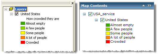

The layer names and map feature descriptions in the Web application's table of contents reflect any layer names or map feature descriptions that you typed in the ArcMap table of contents. The heading is not available in the Web Mapping Application table of contents, but the service name is displayed. See the images below for a comparison.
