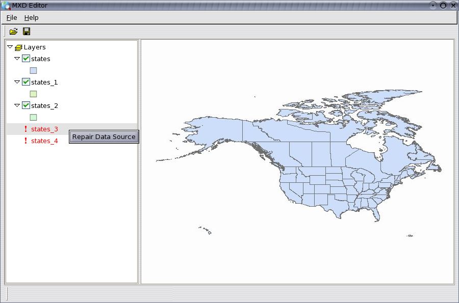

2) Use MXD Path Editor to edit the path in your map document.
Use the MXD Path Editor to reset the pathnames in your map document to point to the proper Linux/Solaris version of each dataset. Make sure all the layers show up correctly.
