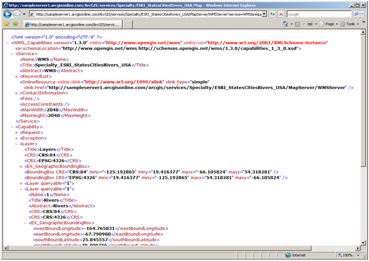

Here's a sample WMS GetCapabilities request URL:
http://sampleserver1.arcgisonline.com/ArcGIS/services/Specialty/ESRI_StatesCitiesRivers_USA/MapServer/WMSServer?service=WMS&request=GetCapabilities&version=1.3.0
Here's the XML response of the request above:

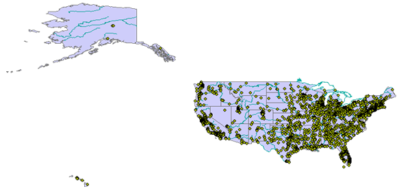

Here's a sample WMS GetMap request url:
http://sampleserver1.arcgisonline.com/ArcGIS/services/Specialty/ESRI_StatesCitiesRivers_USA/MapServer/WMSServer?VERSION=1.3.0&REQUEST=GetMap&CRS=CRS:84&BBOX=-178.217598,18.924782,-66.969271,71.406235&WIDTH=765&HEIGHT=360&LAYERS=0,1,2&STYLES=,,Symbolizer&EXCEPTIONS=application/vnd.ogc.se_xml&FORMAT=image/png&BGCOLOR=0xFFFFFF&TRANSPARENT=TRUE
And here's the map you see in your browser in response to the request above:

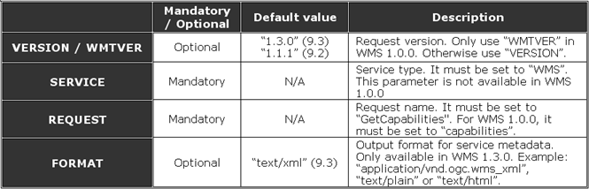

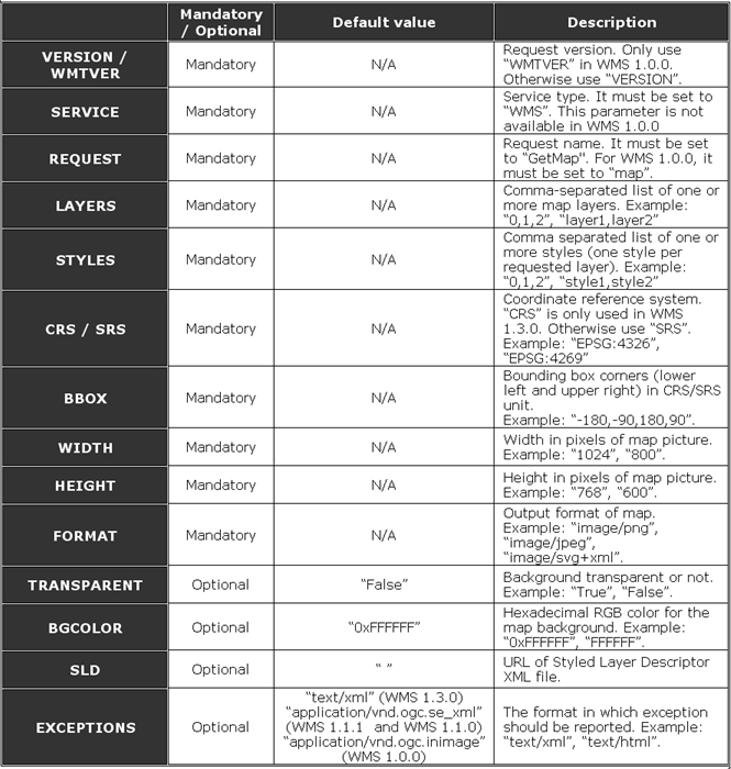

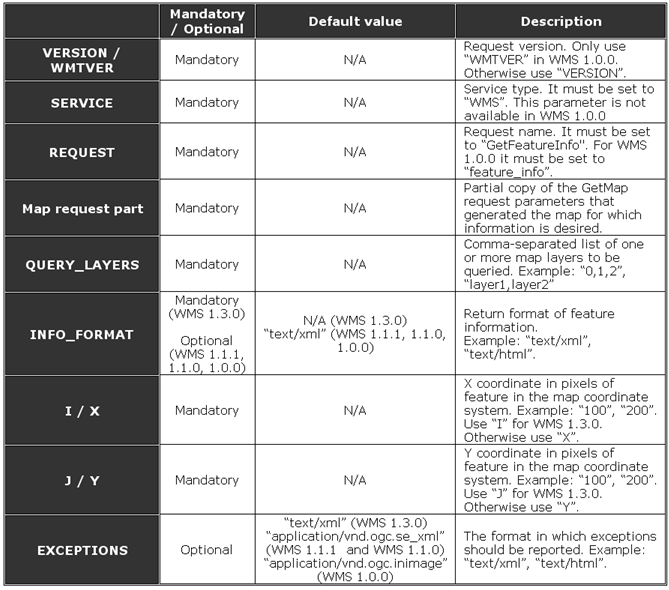

The tables below list all the request parameters that are applicable to the WMS implementation in ArcGIS Server 9.3, which is only a subset of those defined in the specification.
Parameters of a WMS GetCapabilities request URL
Parameters of a WMS GetMap request URL
Parameters of a WMS GetFeatureInfo request URL
