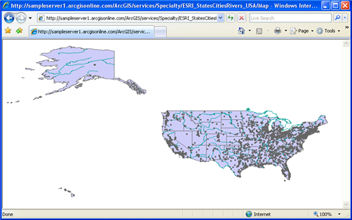

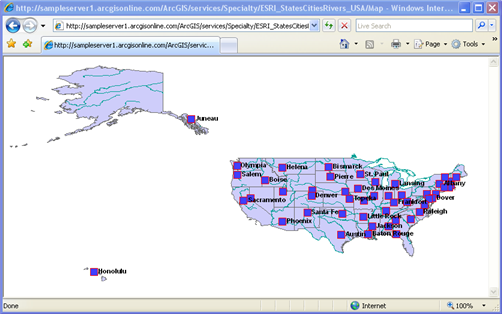

point_pointSymbolizer
Description: An SLD style that uses a "pointSymbolizer" to render features in a point layer
URL of SLD file: http://sampleserver1.arcgisonline.com/arcgis/wms/slds/point_pointSymbolizer.xml
GetMap request: http://sampleserver1.arcgisonline.com/ArcGIS/services/Specialty/ESRI_StatesCitiesRivers_USA/MapServer/WMSServer?VERSION=1.3.0&REQUEST=GetMap&CRS=CRS:84&BBOX=-178.217598,18.924782,-66.969271,71.406235&WIDTH=765&HEIGHT=360&LAYERS=0,1,2&STYLES=,,pointSymbolizer&EXCEPTIONS=application/vnd.ogc.se_xml&FORMAT=image/png&BGCOLOR=0xFFFFFF&TRANSPARENT=TRUE&SLD=http://sampleserver1.arcgisonline.com/arcgis/wms/slds/point_pointSymbolizer.xml
GetMap response:

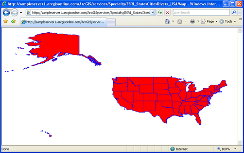

polygon_polygonSymbolizer
Description: An SLD style that uses a "polygonSymbolizer" to render features in a polygon layer
URL of SLD file: http://sampleserver1.arcgisonline.com/arcgis/wms/slds/polygon_polygonSymbolizer.xml
GetMap request: http://sampleserver1.arcgisonline.com/ArcGIS/services/Specialty/ESRI_StatesCitiesRivers_USA/MapServer/WMSServer?VERSION=1.3.0&REQUEST=GetMap&CRS=CRS:84&BBOX=-178.217598,18.924782,-66.969271,71.406235&WIDTH=765&HEIGHT=360&LAYERS=0&STYLES=polygonSymbolizer&EXCEPTIONS=application/vnd.ogc.se_xml&FORMAT=image/png&BGCOLOR=0xFFFFFF&TRANSPARENT=TRUE&SLD=http://sampleserver1.arcgisonline.com/arcgis/wms/slds/polygon_polygonSymbolizer.xml
GetMap response:

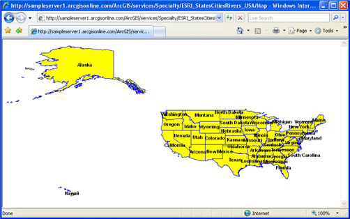

polygon_textSymbolizer
Description: An SLD style that uses a "textSymbolizer" to add text to each feature in a polygon layer
URL of SLD file: http://sampleserver1.arcgisonline.com/arcgis/wms/slds/polygon_textSymbolizer.xml
GetMap request: http://sampleserver1.arcgisonline.com/ArcGIS/services/Specialty/ESRI_StatesCitiesRivers_USA/MapServer/WMSServer?VERSION=1.3.0&REQUEST=GetMap&CRS=CRS:84&BBOX=-178.217598,18.924782,-66.969271,71.406235&WIDTH=765&HEIGHT=360&LAYERS=0&STYLES=textSymbolizer&EXCEPTIONS=application/vnd.ogc.se_xml&FORMAT=image/png&BGCOLOR=0xFFFFFF&TRANSPARENT=TRUE&SLD=http://sampleserver1.arcgisonline.com/arcgis/wms/slds/polygon_textSymbolizer.xml
GetMap response:

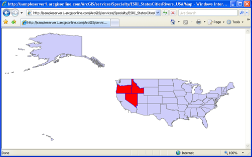

polygon_propertyIsEqualTo
Description: An SLD style that uses a "propertyIsEqualTo" filter to render only a subset of all features in a polygon layer
URL of SLD file: http://sampleserver1.arcgisonline.com/arcgis/wms/slds/polygon_propertyIsEqualTo.xml
GetMap request: http://sampleserver1.arcgisonline.com/ArcGIS/services/Specialty/ESRI_StatesCitiesRivers_USA/MapServer/WMSServer?VERSION=1.3.0&REQUEST=GetMap&CRS=CRS:84&BBOX=-178.217598,18.924782,-66.969271,71.406235&WIDTH=765&HEIGHT=360&LAYERS=0,0&STYLES=,propertyIsEqualTo&EXCEPTIONS=application/vnd.ogc.se_xml&FORMAT=image/png&BGCOLOR=0xFFFFFF&TRANSPARENT=TRUE&SLD=http://sampleserver1.arcgisonline.com/arcgis/wms/slds/polygon_propertyIsEqualTo.xml
GetMap response:

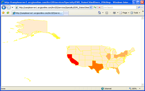

polygon_multiple_rules
Description: An SLD style that uses multiple rules to apply distinct symbology on subsets of features in a polygon layer
URL of SLD file: http://sampleserver1.arcgisonline.com/arcgis/wms/slds/polygon_multiple_rules.xml
GetMap request: http://sampleserver1.arcgisonline.com/ArcGIS/services/Specialty/ESRI_StatesCitiesRivers_USA/MapServer/WMSServer?VERSION=1.3.0&REQUEST=GetMap&CRS=CRS:84&BBOX=-178.217598,18.924782,-66.969271,71.406235&WIDTH=765&HEIGHT=360&LAYERS=0&STYLES=multiple_rules&EXCEPTIONS=application/vnd.ogc.se_xml&FORMAT=image/png&BGCOLOR=0xFFFFFF&TRANSPARENT=TRUE&SLD=http://sampleserver1.arcgisonline.com/arcgis/wms/slds/polygon_multiple_rules.xml
GetMap response:
