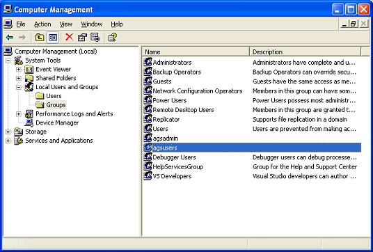

  1. Start the Computer Management application on the server object manager (SOM) machine. Computer Management can be found in the Control Panel under Administrative Tools.
  2. Expand System Tools, expand Local Users and Groups, then expand Groups.
  3. Right-click the ArcGIS Server users group, agsusers, and click Properties.
  4. In the Properties dialog box, click Add. In the dialog box that appears, add those operating system accounts to which you want to grant access to the GIS server. These are typically the accounts that people use to log in to the network from their own computer.
