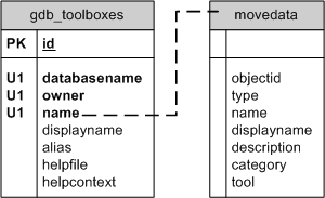

Only two tables are needed to represent toolboxes in a DBMS: a business table to store information about the tools in the toolbox and a system table—gdb_toolboxes—to keep track of the toolboxes. The following are the tables for the movedata toolbox:
These two tables are associated by the name—the value in the name field of the gdb_toolboxes table corresponds to the business table name.
As indicated by the names in parentheses following the table names, the gdb_toolboxes table resides in the ArcSDE administrator's schema (sde) and the business table resides in the user's schema. The gdb_toolboxes table is created when you create the geodatabase; the business table doesn't get created until you create the toolbox.
