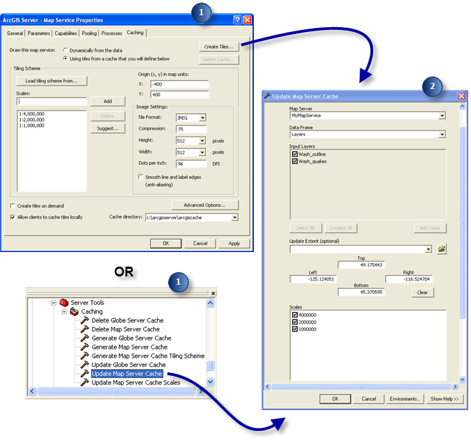

The Caching tab
From this tab in the map service's properties, you can configure settings for your cache. This includes tiling scheme information, such as scales and image format, as well as options like whether tiles will be creatable on demand. You should fill out the settings on this tab before you begin creating cache tiles.
This tab is available in both Manager and ArcCatalog.
For guidelines on using the Caching tab, see Choosing cache properties.
The Manage Map Server Cache Tiles tool
The Manage Map Server Cache Tiles tool allows you to create, update, or delete tiles in your cache. You can access it through the Caching tab in ArcCatalog or through ArcToolbox. It is not accessible through Manager.
Since Manage Map Server Cache Tiles is a geoprocessing tool, it can be scripted just like any other tool to help you update your cache on a regular basis.
For guidelines on using this tool, see Creating cache tiles.
Migration tip: The Generate Map Server Cache tool, frequently used in ArcGIS Server 9.2, has been deprecated. At ArcGIS Server 9.3, you can use Manage Map Server Cache Tiles to create tiles for the cache. If you're creating the cache programmatically, use Create Map Server Cache to initialize the cache, followed by Manage Map Server Cache Tiles.
