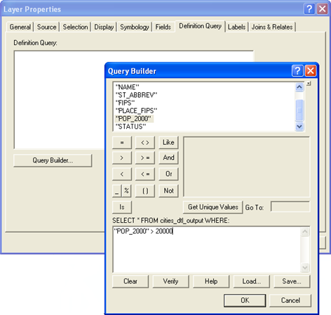

Tip: You may want to set a definition query so that fewer features are visible at this scale. For example, if you have a cities layer, you can set a definition query that limits display to cities with a population greater than 20,000.

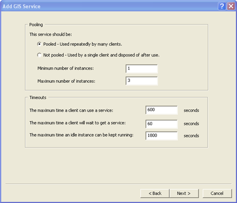

Now you're on the page of the wizard where you can choose the pooling model and number of instances for the service. For cached services, you should always choose the default of Pooled. You can, however, raise or lower the Maximum number of instances to a number greater than 2.
In most cases, a CPU can handle at least 3 instances while caching. More powerful machines, or configurations with multiple SOC machines, can handle even more instances. If you want to use all your server power in creating the cache or if you have a very large ArcGIS Server deployment, you should raise the default maximum number of instances.
You may wonder if you need to increase the default time-out value to something greater than the default, since creating the cache can take a long time. Actually, the caching tools reset the time-out value to be very large before they start creating tiles, so you do not need to change the default time-out value here.

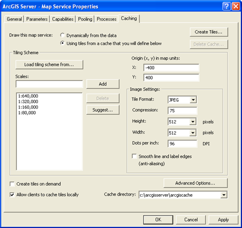

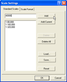

Type one of your scales in the Scales text box, then click Add. You should see the scale appear in the list.
Continue entering scales and clicking Add for each one until you have reached the end of your list.
Change the Cache Tile Format to JPEG. This format produces small tiles and will reduce the disk space needed to store the cache. Clients can also load the tiles quicker.
Note: This step assumes that you are not going to overlay this cache on another service. For overlay services, such as road and boundary networks, you should choose PNG8 instead.

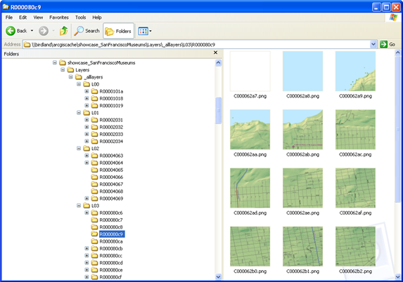

You can use Windows Explorer to get a rough view of the progress of the cache generation.
Go back up to the _alllayers folder and examine the folders prefixed with L (L00, L01, and so on). These folders represent the different scale levels in your cache. The time stamp on the folder tells you when it was generated. Each successive scale level takes longer to generate because it contains more tiles. In this case, where you doubled the scale, each scale level contains four times as many tiles as the previous level.
