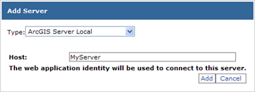

Examine the list of servers in the Available Services box. Does your server name appear, followed by the words ArcGIS Server Local? If not, you need to click Add GIS Server, choose to add an ArcGIS Server Local connection, then type the name of your server and click Add.
Remember: An ArcGIS Server local connection is required for editing. Your Web application will still be available through the Internet, but the application itself needs to make a local connection to the GIS server for the editing to occur.

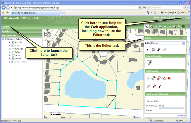

As you view your new Web application, you'll see a list of tasks across the top of the map. You can open the Editor task from this task bar. The Editor task runs inside its own floating panel, which you can move around the screen.
The application has built-in help that you can access by clicking the Help link in the upper right corner. The help has an Editing data section that explains each tool on the Editor task dialog box. This help was created in HTML so that you can customize it if needed.
