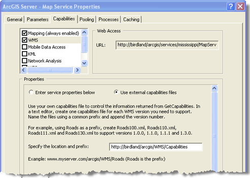

To configure a WMS service to use external capabilities files, you must have at least one WMS capabilities file ready. You can create the file from scratch, but it's often easier to first publish your service with a system-generated capabilities file, then use that file as a template for creating the external capabilities file.
If you want your WMS service to support different versions of WMS protocol--for example, 1.0.0, 1.1.0, 1.1.1 and 1.3.0--you must have one capabilities file for each version of WMS you want to support. Once you've created all of the necessary capabilities files, name them with a common prefix (for example, "capabilities") plus the unique 3-digit version number (For example: "capabilities100", "capabilities110", "capabilities111","capabilities130"). Place all of your capabilities files under a common folder which is accessible from a URL. Then follow the steps below to configure your service to use the files:

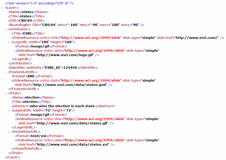

Problem: WMS capabilities files are the only connection between a WMS service and a WMS client, in which the server advertises information while the client consumes it. The WMS specification defines a large set of properties (through xml tags in the capabilities file) to describe each layer in the service as well as the service itself, but many of those properties of layers can not be added or configured when you publish a WMS service through ArcGIS Server using system-generated capabilities files.
Solution: By publishing a WMS service with external capabilities files, you can configure and customize any metadata information for each WMS layer in the service.
Example: This example shows how you can add metadata for a WMS layer to the WMS service's capabilities file. This metadata could include abstract, keywords, URL link to the metadata in standard format, attribution, and even the URL link to the feature data.
