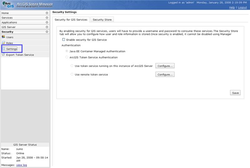

The GIS Server will start challenging user requests only when security is enabled.
Before enabling security on your GIS Server, you need to configure and setup a Principal Store (that contains user and role information) and apply permissions on your GIS services and Web Applications. Ideally, enabling security on your GIS Server must be last step in setting up a secured site.
To enable security on your GIS Server, you need to click the checkbox on this page and choose the authentication scheme for securing your GIS services.
ArcGIS Server at 9.3 provides 2 authentication schemes to secure your GIS services namely the Java EE Managed Authentication and ArcGIS Managed Authentication based on Tokens.
The permission information is written to the WEB.xml file for the service handler applications (REST and SOAP) deployed in the internal Java EE containers. The internal web container will challenge user requests to the secured GIS services.

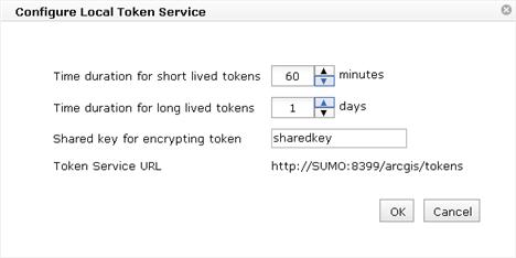

When you select ArcGIS Managed Authentication based on Tokens, you will also need to setup your Token Service. You can start a Token Service on your ArcGIS Server instance or choose to use a Token Service that has been running on some other machine.
To start a Token Service on your ArcGIS Server instance, you need to configure the expirations times and enter a key (text string) that the Token Service will use to encrypt the tokens.
For more information on tokens and Token Service, see the 'Tokens and Token Service' topic in the documentation.

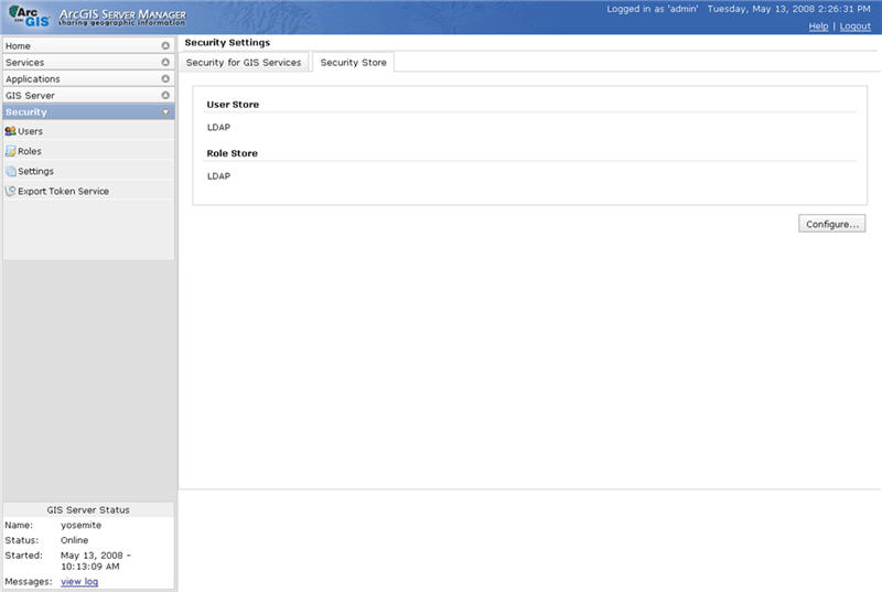

The screenshot below shows the web page for configuring the Security Store.
Security Store Configuration
You begin setting up the Security Store by clicking the 'Configure' button on the Security Store page. This will bring up a wizard that will help you setup the user and role store individually. The wizard will only allow the supported configuration for user and role stores (see the table above).

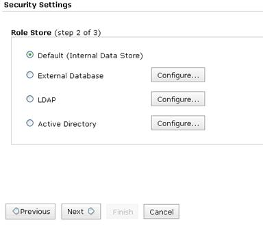

Step 2 of 3: Configure a Role Store
Select the store which will hold the role information.

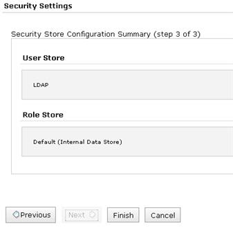

Step 3 of 3: Security Store Configuration Summary
This page summarizes the store configuration. If you are satisfied with the configuration you can click 'Finish' or make the necessary edits.

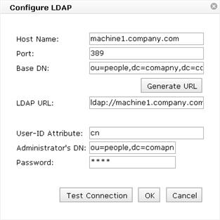

The screenshot below shows the dialog for configuring an LDAP as a user store.
The following table describes each of the fields and buttons in 'Configure LDAP' dialog:

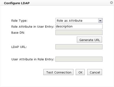

The screenshot below shows the dialog for configuring the LDAP as a role store when roles are maintained as an independent entry.
The following table describes each of the fields of the dialog:

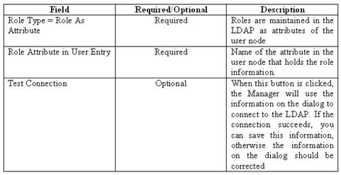

The screenshow below shows the dialog for configuring the LDAP as a role store when the roles are maintained as attribute information of a user entry.

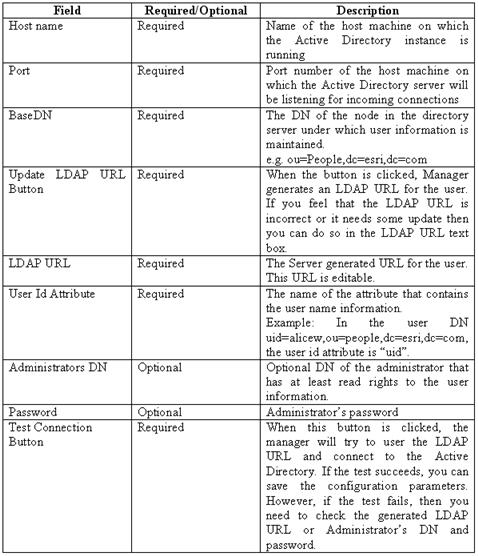

ArcGIS Server can leverage user and role information that is available in Microsoft's Active Directory. The Server treats Active Directory as a read-only source of user/role information and hence administrators cannot use the Manager to add/edit/delete users or roles.
The screenshot below shows the dialog for configuring an Active Directory as a user store.

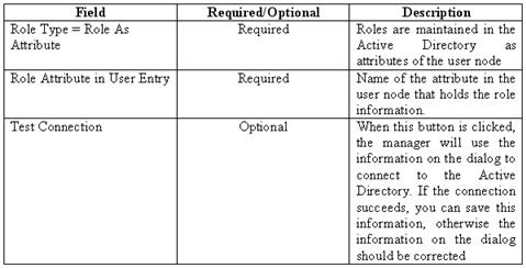

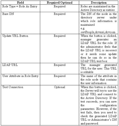

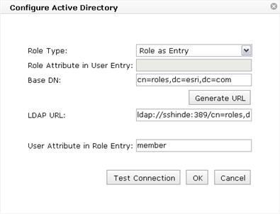

The screenshot below shows the dialog for configuring the Active Directory as a role store when roles are mainatained as independent entry.
The screenshow below shows the dialog for configuring the Active Directory as a role store when roles are maintained as attribute information of user entries.

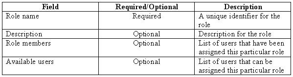

Adding a new role
The 'Roles' link under the 'Security' tab lists all the roles currently in the system. To add a new role, click the 'Add Role' button on the page. A dialog box will open in which you can enter role information.
The table below describes each field of the 'Add Role' dialog:

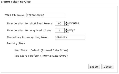

The 'Exporting Token Service' link under the 'Security' provides you with an ability to export the token service web application so that it can be deployed in a application server. You can deploy the token service web application onto a centralized application server that is accessible to all the instances of the ArcGIS Server in a distributed system.
You can configure the Token Service to look up user and role information from the configured Security Store or you can setup a new Security Store configuration for this exported Token Service. You also need to enter a shared key that will be used to encrypt/decrypt the token generated by the token service and the short lived (default) and long lived (maximum) token expiration times.
For more information on the Token Service, see the 'Token Service' topic in the documentation.
When the 'Export' button is clicked, Manager generates a '.WAR' file that can be deployed on any web server.
