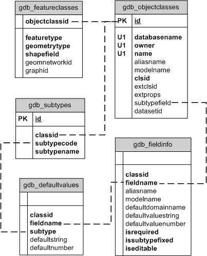

When a feature class is created through ArcGIS using ST_Geometry storage, a business table with an ST_Geometry column is created in the owner's schema. Also, records are added to the sde_layers, sde_table_registry, sde_geometry_columns, sde_column_registry, sde_spatial_references (if a spatial reference was defined), gdb_object_classes, and gdb_featureclasses tables in the SDE user's schema to track information about the feature class.
Once feature classes have been added to the database, you will find there are also several i tables and stored procedures in your database. These stored procedures and i tables are used for generating feature IDs for feature classes. The i tables contain a number in their name. This number corresponds to the registration_id of the feature class in the sde_table_registry table. Editing these tables or stored procedures is not supported and highly discouraged.
To open a diagram of a feature class stored in PostgreSQL using the ST_Geometry type, click the following link. (You need Adobe Reader to open the diagram.)
PostgreSQL ST_Geometry feature class diagram
Dashed lines indicate implicit relationships between columns; solid lines indicate explicitly defined relationships between columns.
The database name field in the gdb_objectclasses, sde_table_registry, sde_columns_registry, and sde_layers tables contains the same value. Similarly, the owners fields in these tables all contain the same values, although the implicit relationships are not drawn on the diagram to avoid clutter.

Subtypes in a PostgreSQL DBMS
The following system tables in a PostgreSQL DBMS are used to track information about subtypes applied to a field in a feature class:
In this example, the Laterals feature class is identified in the gdb_objectclasses system table. Additional information about the feature class is maintained in the gdb_featureclasses and gdb_fieldinfo system tables.
The subtypes for feature classes are tracked in the gdb_subtypes system table, the default values for the subtypes are tracked in the gdb_defaultvalues system table, and the fields to which these apply are tracked in the gdb_fieldinfo system table. The subtypes are associated to the feature class by way of the gdb_objectclasses table. The gdb_defaultvalues table is associated with the gdb_subtypes table by the subtype code, which is stored in the subtypecode field in the gdb_subtypes table and the subtype field in the gdb_defaultvalues table.
The name of the field to which the subtype applies is stored in the subtypefield column of the gdb_objectclasses table. This field is linked to the fieldname column in the gdb_fieldinfo table, which in turn is associated to the fieldname column in the gdb_defaultvalues table.
