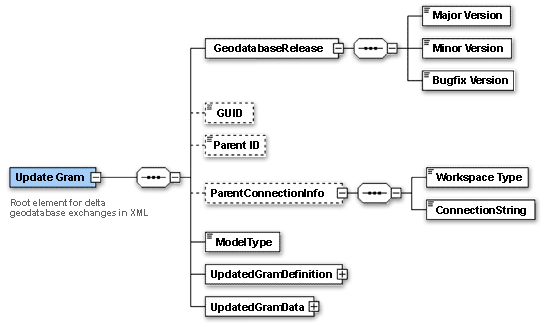

The geodatabase XML Data Changes document
As part of geodatabase transaction and version management, users want to share and work with change-only record sets. The XML Data Changes document is used to share changes or updates among geodatabases and between the geodatabase and external systems. It does this by only distributing changes that can be tracked in the geodatabase using versioning.
The ArcGIS disconnected editing framework allows you to check data out of a database into a separate geodatabase, then edit the data without having a live connection to the parent database. Once the editing is done, it is possible to export only the changes (not all the data) to an XML file. This file can be used to subsequently check in the changes to the parent database.
This is also a key part of geodatabase replication.
The primary information of a Data Changes document is an UpdateGram in which only changes are delivered as part of the XML document.
The elements contained in an XML Data Change document

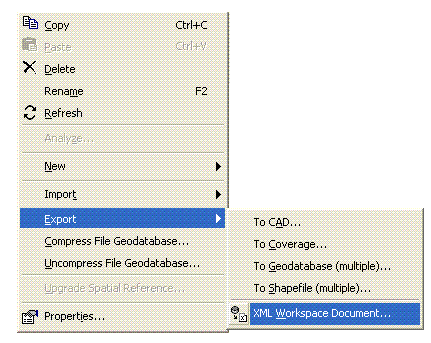

Using geodatabase XML in ArcCatalog and Geoprocessing
ArcCatalog and the geoprocessing framework in ArcGIS contain a number of functions to import and export geographic data. Some typical tasks that users perform in ArcGIS with geodatabase XML include
For example, using ArcCatalog, you can right-click on a geodatabase or feature dataset and create an XML Workspace document, which can be used to share a geodatabase schema or to copy the contents, rules, objects, and behaviors to another geodatabase.
Whole geodatabases or individual datasets can be transferred using geodatabase XML documents.
