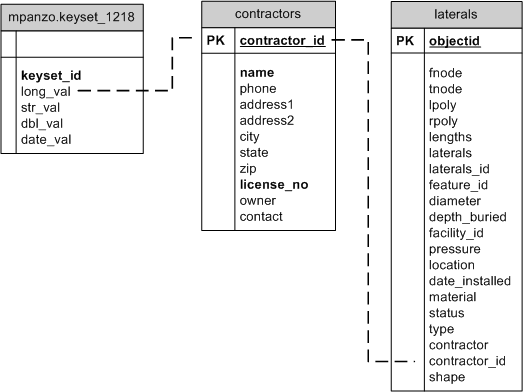

The following is a keyset table for a selection made between the related tables laterals and contractors. In this case, the long_val field would be populated and contain the values of the contractor_id field on which the relationship class between laterals and contractors is based.
Keyset table and associated business tables in Informix
<owner>.keyset_<process_id>
