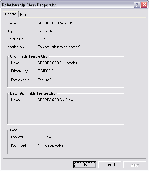

You can view information about relationship classes by right-clicking the relationship class and clicking Properties to open the Relationship Class Properties dialog box.
