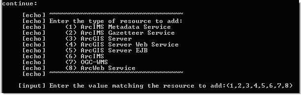

Configure a Metadata Service
  1. Enter "2" to choose the ArcIMS Metadata Service for this Metadata Explorer.
  2. Enter the server location where the Metadata Service resides.
    • If you are connecting through your network using TCP, input the server name.
    • If you are connecting through HTTP, input the full URL.
  3. If you are using a TCP connection, input the ArcIMS Application Server port number. The default value is 5300. Otherwise, add nothing and press Enter.
  4. Input the Metadata Service name. The name is case sensitive.
  5. At the prompt asking if you want to add another resource, enter "y" unless you do not plan to include a Gazetteer or Search Map service. In this case, enter "n".

  1. Enter "6" to choose the service.
