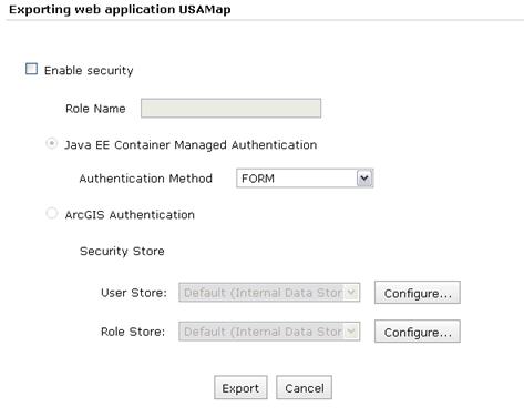

The screeshot below shows the web page for exporting a web application with security configuration.
You begin enabling security on your web application by checking the 'Enable Security' checkbox. If you don't want to secure you web applications, you must leave this checkbox un-checked and proceed to export.
Manager will populate the 'Role Name' text box with all the roles that currently have permission to access this web applications. You can edit the roles this comma separated list and add/delete roles. Ideally, the list of roles must be synchronized between a development and production system.
You then need to choose between Java EE Container Managed Authentication and ArcGIS Authentication.
Here, the list of allowed roles are written to the web applications WEB.XML (deployment descriptor). The application container in which the web application is deployed will challenge the user based on chosen format (Basic, Forms or Digest). The user and role information must be present in the application container's realm for the authentication and authorization to work.
Here, the web application will expose a web page for users to log into. You can configure the user and role store which the web application will use to authenticate and authorize incoming requests.
