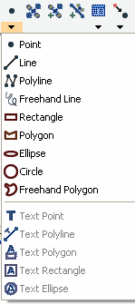

Feature Type Menu
Point
Activates the point feature type for data capture. Tap the map to add a point feature at the tapped location. The point feature type remains active for capture until another tool is activated.
The Point button is only available when editing is turned on for a point layer in the Start/Stop Editing drop-down list or on the Table of Contents dialog box.
Line
Captures a straight-line feature. The Line button is only available when editing is turned on for a line layer in the Start/Stop Editing drop-down list or on the Table of Contents dialog box.
The Line button allows capture with the pen but not with incoming GPS coordinates.
Polyline
Activates the polyline feature type for data capture and starts a new line feature. The polyline feature type remains active for data capture until another tool is activated. Tap the map to add a vertex at the tapped location and tap the Add GPS Vertex button to add a vertex at the current GPS location. While the Add GPS Vertices Continuously button is depressed, vertices are continuously added at the current GPS location. The Polyline button is only available when editing is turned on for a line layer in the Start/Stop Editing drop-down list or on the Table of Contents dialog box. The Polyline button allows data capture with the pen as well as incoming GPS coordinates.
Freehand Line
Captures a freehand line feature using the pen.
The Freehand Line button is only available when editing is turned on for a line layer in the Start/Stop Editing drop-down list or on the Table of Contents dialog box.
The Freehand Line button allows data capture with the pen but not with incoming GPS coordinates.
Rectangle
Captures a rectangle polygon feature using the pen.
The Rectangle button is only available when editing is turned on for a polygon layer in the Start/Stop Editing drop-down list or on the Table of Contents dialog box.
The Rectangle button allows data capture with the pen but not with incoming GPS coordinates.
Polygon
Activates the polygon feature type for data capture and starts a new polygon feature. The polygon feature type remains active for data capture until until another tool is activated. Tap the map to add a vertex at the tapped location and tap the Add GPS Vertex button to add a vertex at the current GPS location. While the Add GPS Vertices Continuously button is depressed, vertices are continuously added at the current GPS location. The Polygon button is only available when editing is turned on for a polygon layer in the Start/Stop Editing drop-down list or on the Table of Contents dialog box. The Polygon button allows data capture with the pen as well as incoming GPS coordinates.
Ellipse
Captures an ellipse polygon feature using the pen.
The Ellipse button is only available when editing is turned on for a polygon layer in the Start/Stop Editing drop-down list or on the Table of Contents dialog box.
The Ellipse button allows data capture with the pen but not with incoming GPS coordinates.
Circle
Captures a circle polygon feature using the pen.
The Circle button is only available when editing is turned on for a polygon layer in the Start/Stop Editing drop-down list or on the Table of Contents dialog box.
The Circle button allows data capture with the pen but not with incoming GPS coordinates.
Freehand Polygon
Captures a freehand polygon feature using the pen.
The Freehand Polygon button is only available when editing is turned on for a polygon layer in the Start/Stop Editing drop-down list or on the Table of Contents dialog box.
The Freehand Polygon button allows data capture with the pen but not with incoming GPS coordinates.
Text Point
Captures a text feature relative to a point, using the pen.
The Text Point button is only available when editing is turned on for a text or multi-feature layer, such as a graphics layer.
Text Line
Captures a text feature relative to a line, using the pen.
The Text Line button is only available when editing is turned on for a text or multi-feature layer, such as a graphics layer.
Text Polygon
Captures a text feature relative to a polygon, using the pen.
The Text Polygon button is only available when editing is turned on for a text or multi-feature layer, such as a graphics layer.
Text Rectangle
Captures a text feature relative to a rectangle, using the pen.
The Text Rectangle button is only available when editing is turned on for a text or multi-feature layer, such as a graphics layer.
Text Ellipse
Text Ellipse Captures a text feature relative to an ellipse, using the pen.
The Text Ellipse button is only available when editing is turned on for a text or multi-feature layer, such as a graphics layer.
