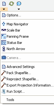

Options Menu
Options
Opens the ArcPad Options dialog box
Map Navigator
Displays or hides the Map Navigator.
Scale Bar
Displays or hides the scale bar.
Panning Frame
Displays or hides the map panning frame.
Status Bar
Displays or hides the status bar.
North Arrow
Displays or hides the north arrow in the map view
Camera
Opens the camera tool for taking stand-alone photographs with the connected camera.
Advanced Settings
Opens the Advanced Settings dialog box.
Pack Shapefile
Packs a shapefile by removing records flagged for deletion.
Reproject Shapefile
Reprojects a shapefile to another projection and/or datum.
Export Projection Information
Exports ArcPad projection information into CSV and text files.
Run Script
Opens the Script dialog box, which can be used for testing scripts.
Tools
This sub menu allows you to open and access properties of ArcPad extensions.
Refresh
Refreshes your current map.
