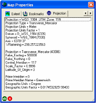

Checking if projection information is understood by ArcPad
You can check if ArcPad has understood, or correctly interpreted, the projection information in the projection file (.prj) or projection strings sent by ArcIMS servers or extensions to ArcPad. Open the Map Properties dialog box and tap the Projection tab. All the names and values listed on the Projection tab should be identical to the names and values listed in the projection file (.prj). If they are not the most probable cause is that there is an error in the projection file or ArcPad does not support the projection.
