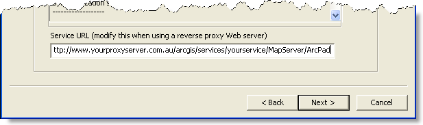

If your ArcGIS Server environment uses a reverse proxy server, you should add the server's url on the GIS Service page of the wizard.
