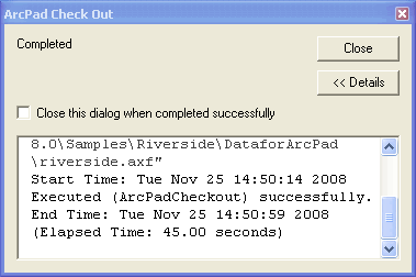

The results of the check out process are shown in a dialog box.
