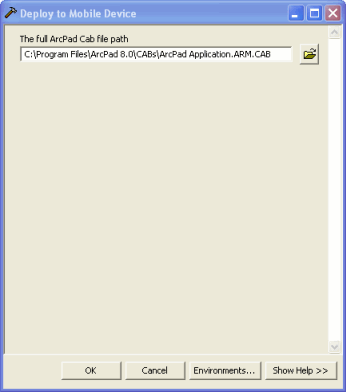

The Deploy to Mobile Device tool allows you to deploy any Windows CAB file to your mobile device that is connected to your PC. You can use this tool to deploy a CAB file containing compressed ArcPad data or an application such as the ArcPad installation CAB. You can also use this tool in a model in order to deploy a complete solution containing ArcPad applicaiton and data. When you select this tool, the following dialog opens:
Use the folder icon to browse to the location of the CAB file.

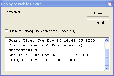

The results of the deploy process are shown in a dialog box:
